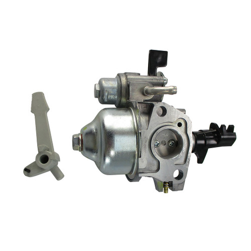

while changing out the carb I noticed fuel in the port that puddled up. Might have been me digging around in the port and messing things up, but I did notice that a plastic shim part was not aligned to the port so I matched it.
I’ll take off the carb in a bit and see if that fixed it

Next time, turn the low speed mix screw out 1/2 turn out at a time, test and see how the carb accepts it.
Get temp in the engine, tuning cold does nothing.
About 3 hard dead stop yanks, then add another 1/2 turn out.
That carb should respond better or worse, there's gonna be a sweet spot, if not, you probably need to pop the low speed jet out and clean the low side circuit.
Take it completely apart and remove all the rubber and plastic parts, blast every hole real good with cleaner and compressed air
You could also try the stock carb with the stock low speed jet, and also the .020" outta the arc carb, if it fits.

The low speed jet and e-tube is where you gonna see that yank up outta the hole.
I'll see if I got any 140 e-tubes, and get a pic for you. They make a good stock carb hit really hard down low.
Some cheap stock carbs WONT accept the 140 e-tube or any low speed jet bigger then a .018", I tried, some of them jus really suk,
