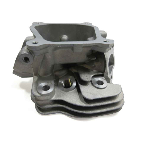

Ima check valve lash later, something just ain’t sitting right with me. I’ve convinced myself that the bottom being slightly curved is “rolling” the valve train as it heats up and causes my issue.
Idk how to straighten it out, because sanding it is what got me there in the first place.
