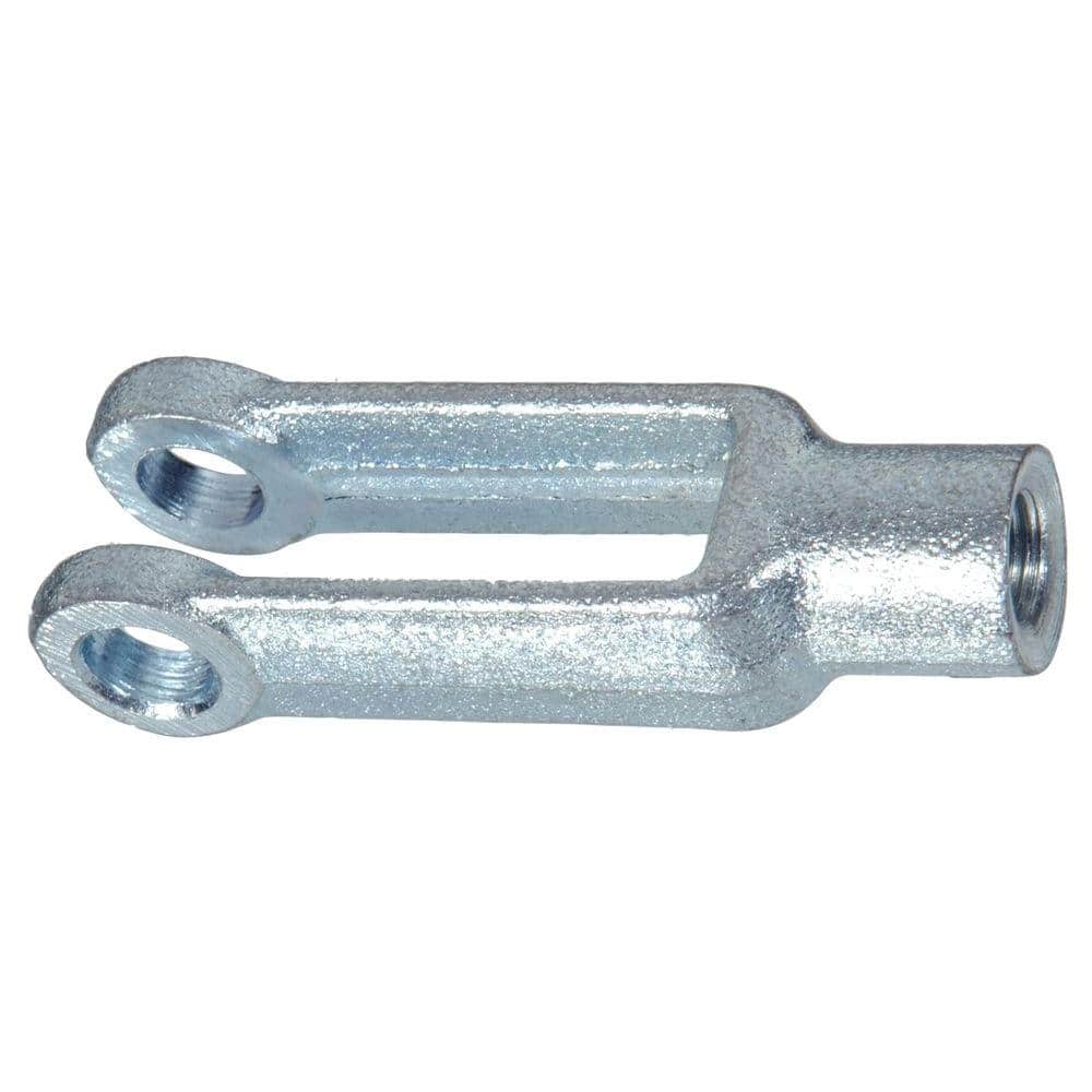

I would pick up a section of all thread rod, two yoke ends and some bolt/nut combos. Measure your distance, thread a yoke on each end then run the nut & bolt through to secure. Refer to image. I hope this makes sense. The yoke goes over the brake pedal arm on one end and the caliper arm on the other.

GeorgeG4
25
20
Yeah, I’d like to find some of those locally. Unfortunately, we don’t have many options here where I live.
Karttekk
2,003
694
Elizabeth, PA
Make your own. Get the threaded rod and yokes at Home Depot or a hardware store. All standard stuff. You can get 5/16" solid rod and add the threads with a die. Get creative!
GeorgeG4
25
20
I live in Lincoln Maine. The closest Home Depot is an hour away. I’ve got the threaded rod. I’m just gonna have to make some thing for the end. which I can do. Just be easier and a lot nicer to just screw on a yoke on both ends.

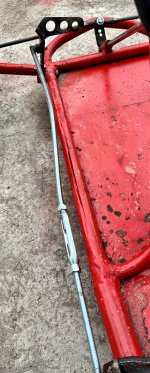

GeorgeG4
25
20
No, I literally checked with every hardware store in town and automotive stores and Aubuchon. None of them have yokes.
So I ended up buying a couple sticks of threaded rod and a turnbuckle put a slight offset in the rod and then I welded a bolt on each end. I also flipped around my brake caliper, so the lever is down. I then took the brake pedal off, drilled another hole higher up for more leverage. I can actually say that the brakes work now they’re not perfect but they will stop you. I believe I haven’t had a chance to test it really because we’re getting a lovely snow storm here.
I’ll post pics when I get some.
GeorgeG4
25
20
Sounds like you're getting somewhere. Looking forward to the results. It's frustrating to learn this stuff but I bet you'll feel pretty good when you can finally fly around and stop!
Lol yup. I just want it safe for anyone who may ride it or if I sell it.

GeorgeG4,....You know that you never failed at any of those attempts to get the brakes to work, the way you wanted to.
You just learned several ways of how the brakes don't work, the way you wanted them to work.
You are correct.
Thank you
2,788
3,739
Not bad, not bad at all. You showed GOOD ingenuity, and it looks presentable.
More importantly you got your brakes working good enough that you feel comfortable driving your kart. Way To Go.
