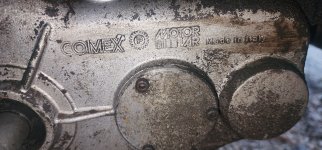

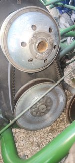

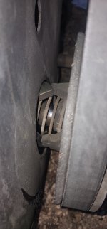

What gearbox is on the 613? Not finding much specs for it. It's possible a 670 might work. Could also look at a smaller V-twin.
Raven210
These are some pics of what I could get ... i need to power wash it and get better pics
4,393
826
Definitely looks like it needs a seal for one of the shafts, might as well drain and refill it with new gear oil. A Predator 420 would be a step up to what you have and would be a cheaper bolt on replacement with next to no modifications to do.
