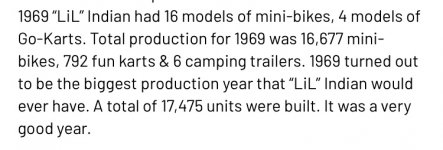

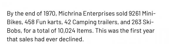

Down the rabbit hole :unsure: 16 different models of mini bikes available from Michrina enterprises in 1969 and no mention of model changes for 1970. So 9,261 divided by 16 says there is about 578 of each individual model sold in 1970. Heck even if they only focused on 10 models in 1970 that would still be extremely low production numbers.FDF4EBAC-A9A5-4CFD-AFBA-545193DD0920.jpeg670C1AE4-397F-443D-8C39-01430543A3C2.jpeg
