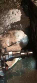

maybe the Kid didn’t bring me junk after all.. maybe the smallest bit of rust on the one weight. The cam and lifters look new? So i’m gonna clean it out with rags for any dirty oil leftover oil it all really well and start to get the side cover back on. Predator timing is dot to dot right?D358CA5D-DDFF-41B1-AD2C-20C905845A92.jpegDA93D12B-9639-468E-9E5D-151C8C34A4B3.jpeg942F9784-A934-4800-876E-BDD5FE58A884.jpeg
