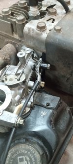

Or you can attach a throttle cable from the rear of the Pulsa Jet carb, connect it directly to the butterfly. There’s a circular groove cast into the carb body, as if to hold throttle cable there. It was used for a stationary throttle, like the set-it-and-leave-it kind seen on a garden tiller.
This is an adaptation but whew, I don't like that compression spring on there. Too much coil bind.

Many such cases and many people have done it. I prefer the factory setup with tank mounted carb just for the compactness and economy of space *in most cases*.
I did a variation of this. Thanks

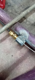

For my throttle, I use a bicycle derailleur cable and secure it with a 3/16 x 1/8" npt ferule fitting screwed into a 1/8" npt coupling welded to the frame.

Nice and clean. What does it look like at the pedal, an eyelet on the end of the cable?

I use the ball end at the carb. On the pedal end, I grind two flats (about an 1/8") opposite each other and immediately beneath the head of a 5/16 bolt and then I drill an approximately .100" hole through the bolt. I thread the cable wire through the hole, add a flat washer and then a nut to clamp the cable against the head of the bolt. I use the remaining approximately half inch of the bolt to pass through the pedal and use a nylock nut to fasten it. I tighten it just enough to let it pivot.
