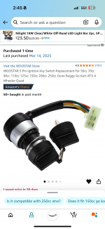

Honestly i wanted to remove the ignition switch and wire this starter I bought. If you can let me know how you wired it that will be great. I’m going to cut the connector and solder the wires
What I did was use a three wire ignition switch for the starter (only used two wires obviously) and a regular toggle/rocker switch for the power/kill switch.
