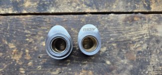

The cam i put in El Chingon. The one on the right is a bigger cam. The left one is stock.
Reference point is the center of the shaft.
From there, to the top, of the stock lobe is the same distance as on the modified cam.
The difference is on the base .
See how the distance from Reference to 6o'clock is greater on the stock vs the modified?
This means the lifter/follower travels a greater distance.
It starts lower.
The modified cam on the right also has a longer duration. The lobe is wider and not as pointy.
Does that make sense?
