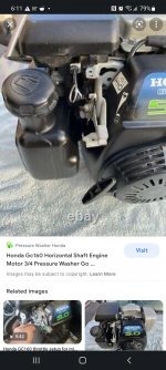

You have the same engine as mine. If you can look for the manual throttle control lever on ebay or somewhere. That way it'll be just like any other small engine. Then just put a spring so it returns to idle after loosening nut.
