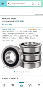

I got this 1 welded, now it matches the other side.Ok got the lash set to .003" broke the front control arm redid it again and found 1 bearing but both need to be replaced on the front drivers wheel anybody like oreillys or autozone have one of these 3/4" x 1 3/8" bearings? If so how would I find one? View attachment 142969
