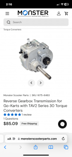

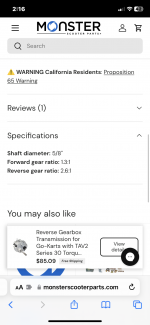

I have not yet got a chance to order the new springs, but it does the same thing about every hour of driving. I was hoping to get some insight from everyone regarding speed. I am maxing out around 18-19 mph. I am not sure that is a problem for me, but just trying to make sure that that all seems right.
With recent rains, when driving, it will kick out the tired and get moving, which most who drive it consider to be pretty quick however, it quickly tops out at its speed, which I assume is the governor. Given my tires, sprockets, and setup, does this seem correct? I thought people were telling me it should be a bit faster on the top end, and I am just worried I may have miscalculated something.
1,857
20 mph might be right for 3600 rpm with a governor.
-What size TIRE diameter?
-What sprockets are you using? How many teeth on the gearbox? How many on the axle?
-What gearbox is it? I’ll have to look up the internal reduction ratio of the gearbox unless you know it.
gjones5252
25
18
tire size 20x10-9 and 19x7-8
10:60 for the gear ratio for the chain
Gear Ratio: Forward- 1:2; Reverse- 1:2:6
1,857
I would expect 3600 RPM to be closer to 28 mph with that set up.
if the gearbox was backwards, I’d expect 3600 rpm to be 14mph.
Is the tire pressure maxed out?
