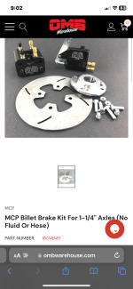

I also need any recommendations for the brakes. I haven't even begun to learn about that.
Thanks in advance and hopefully the pictures help explain what I am rambling about.

They sell kits for brakes. Expensive option for a 1.25” live axle in the photo. Chinesium options available on the interwebs. Can you save the rotor and hub? Then you only need the caliper and master cylinder and can spend less.

Looks like you already have a master cylinder and lines if im not mistaken. Brakes should be a matter of getting a caliper and mounting it onto the rear disc. Looks like It will take a little fab work for a bracket.

I do have the master cylinder but the oil glass viewing screen is broken and I am not sure if it is even functional. I still have the calipers and all but not sure how or what to test with them.
The rotor is salvageable as it's bolted on but the hub is welded to the axle. As it stands I am going to have to flip the axle for the motor to be able to line up and not be pushed way out to the side.
