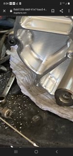

I pointed out the wrong hole. Its this one. It looks like yours doesn't have it.
They may have stopped doing that hole, because its literally drilled all the way through so oil leaks out.20211115_181918.jpg
