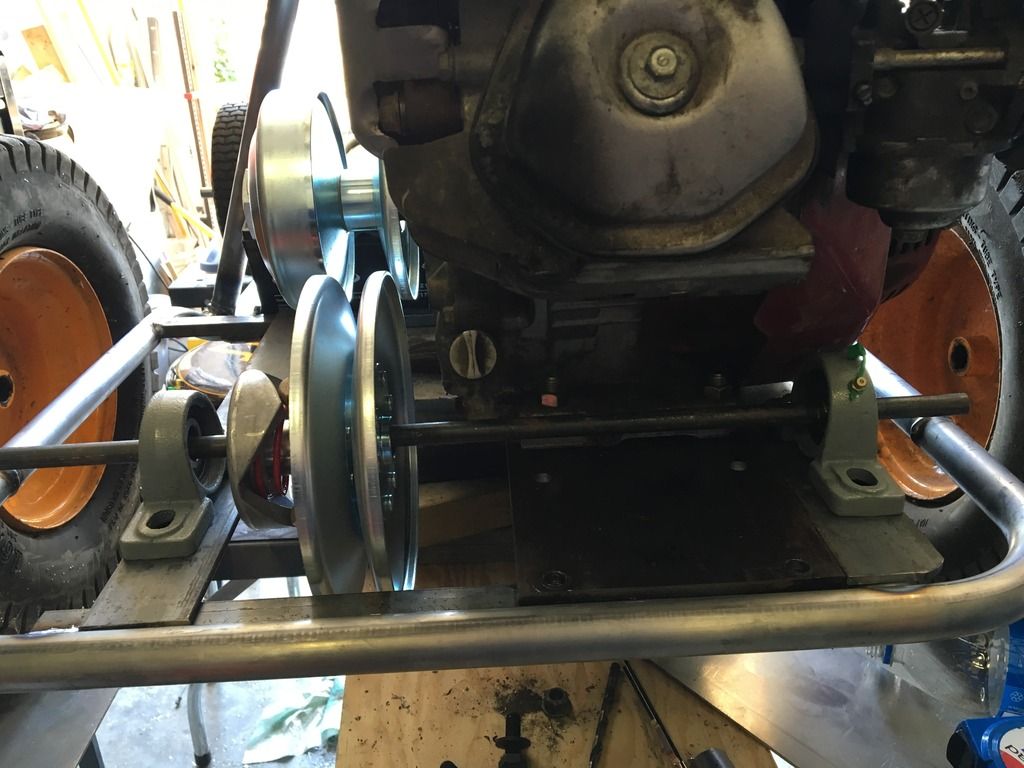

Ok, so I got my 40 series clutch, not sure it's a comet though. Looks like a Chinese knock off. Anyways it was larger than I thought so I need to rethink the jack shaft. I'll add a couple pics, of a mock up. Will this work by putting the sprockets on the left side of the kart?

If that...but it's just a mock up...he won't be using it.
EDIT: And that's closer to what I was thinking D, but with another plate much closer, that's a lot of span...and plate is cheaper than steel shaft.

No room for a middle one, hits the engine base, or I cut the frame and lengthen it. You can imagine how excited I am about that route. Do they make s more compact pillow block?
They make them out of stamped steel as well. I assume those are less "heavy duty" than the cast ones. I mean to try them sometime.

Here's the type of bearing support I was referring to:

But if I turn it around the fixed shieves are opposite, that can't be right, what am I missing here?
that is the way the 40 series is made, the way you have it is designed to use with the yellow spring flip it around and than u can use it as u bought it

By the way. check out the bearing hangars there in the above photos.
Also I recall someone using those Cheapie ones, that Ez was showing.
Oh yeah it was a drift trike jack shaft, he welded them to give extra support.
Edit Here is the thread: http://www.diygokarts.com/vb/showthread.php?t=29207&highlight=drift+trike
Kinda cheezy I guess, and plus you have a 390 yanking on that jack shaft.
