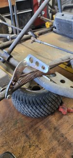

Oh okay. By any chance would you know what springs would work? I do have some but they aren't strong enough to pull the lever back down when letting off the gas pedal. Also are you saying put a spring in these

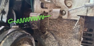

Put a spring there, right opposite of the attachment point. The spring has to be pretty strong to ensure it works and can overcome any friction in the setup plus the weight of that heavy pedal. You might have to shop automotive "throttle return springs"...

Oh okay. I'm guessing I leave the spring that's already there. Other end is connected to where you rev the engine (sorry not sure what it's called) however when I look up what that spring us called it says throttle extension spring

There's a spring there already Hellion. You almost drew right over it.
It looks like the governor shaft on the left.
Blackheart. Looks like your kart has lots of patina. There will be many things that are going to be stuck and not functioning properly. But one at a time.
Start at the pedal. Remove the cable. Does the pedal move freely? Here is a good place to put a return spring.
It's not that complicated. Here's one of mine.
Next check the cable. Detach it from the other side. Can you move the cable inside easily?
Follow the path. The part where you just took the cable off. Move it see what all else is moving with it. Does it all move freely? Pivots will need to be clean and lightly lubed.
Blackheart and WTR: I think that other spring is a governor spring but I could be wrong, anyway you can tell it is not strong enough. See the manual I posted. Page 26 drawing 16. I hate that manual, obviously written for experienced mechanics and not neophytes. 😤

I'm pretty sure that spring is the governor spring. I've been trying to figure out the model number. I'm not sure but I think it's 1P52F (probably wrong)
