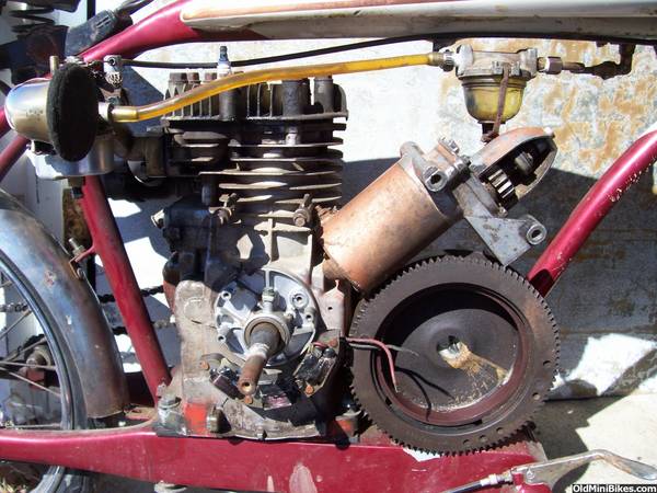

when i took the flywheel off my briggs, there was an extra half circle area and bolt holes for a second coil.
take the blower housing off, loosten the flywheel nut, pry off the flywheel while tap the flywheel nut, take it off, and look if you can put in a second coil.
this isnt my pic, but look at the half of charge coil. there are bolt holes for another.

Hey, I might just look at that Bluethunder! We have a spare engine just like the one on our kart, so I have a 2nd coil if there is room for another! Thanks!

Well took the flywheel off our parts motor and to my disappointment, there wasn't a coil on it. :furious2:
