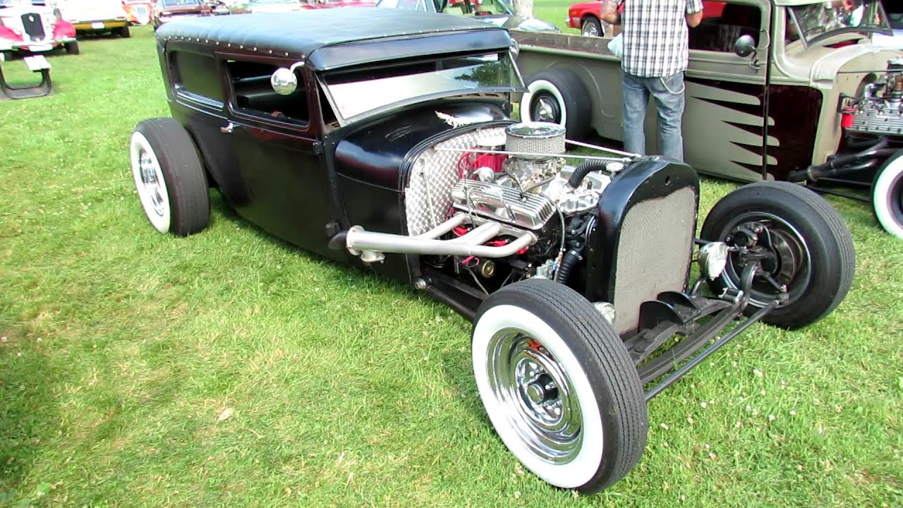

exhaust will be piped out the sides and down and end up looking like an old hot rod hopefully

TIGL any reason for the exhaust to go all the way back?
Why not make some fake zoomies around the one real exhaust. I think that would look sweet on that design.

The rods holding the exhaust in place are actually stick welding electrodes with the flux knocked off since we have a bunch laying around, I also used one to stabilize the back of the chain guard. I will probably make a better bracket once the thing is more fleshed out but until then I just wanted to take some of the weight off the studs (as you mentioned). The route it takes now is just to get the noise and fumes back and out of my face. Hotrod pipes would definitely fit the look i'm going for so maybe I'll look more into that. thanks for the suggestion!
