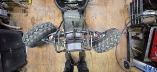

So, l need some input from all you engineers, engineer wannabes, experienced ols geezers and just general noitalls.
how much angle should a front steering turn the wheels? Assuming straight is 0 degrees, what is adequite? 30, 45 dergees? The has to be a point of diminishing returns?
this classifed pic from the skunk works, shows what they are working on.
View attachment 151310View attachment 151311
There is about 32-degrees in one direction or 64 degrees, for those math challenged and common core math students. At speed i only need a few degrees, but low speed turning might suffer. Its already bad due to the locked rear axle.

Good question. Planning for ackermann, the 32 degrees you have in one direction would seem to limit the outside tire to a little under 30? Not horrible, especially for a short wheel base, but I would think less than ideal?
4,330
6,984
Depends on how hard you planning on drifting
Probably not that much. No way l'm getting 80 deg.
l'll be happy if l can squeak another 5 deg outta it. Considering how it gets used, l think it'll be ok.

You going to be a couple inches wider in the front so rear tires follow front?
Not exactly sure where this gonna end up. There is some "flexibility" in da plan.
Rear width is 64. I go much beyond that and l create A LOT more work.
l mocked up the lower A arm in order to see how/if this is gonna work.
l like what im seein so far.
