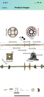

I ordered a Duromax 440cc, a torque converter, a single seat (as i am going to make this a single seat kart), a live axle kit, brake caliper, cables, rear wheels and tires, and new front tires. All from amazon.
Here is a pic of the live axle kit i ordered. Honestly pretty concerned on how im going to go about this, when i ordered this, i thought the brake disk and sprocket would be able to move left or right on the axle but it seems to be welded in place.
