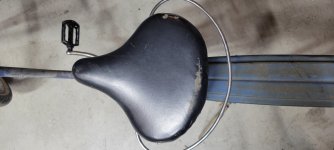

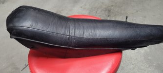

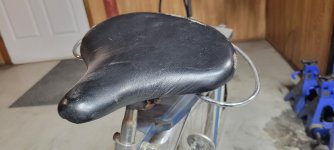

Working with heavy marine grade PLU jagged corners on the foam doesn't matter much. I've ripped corners off like stale bread to get the roundness in all directions I wanted. What matters most is that the tension put into the surface material whether it's leather, kid skin, PLU, or denim... is even and tight
The grab bar saddle is kid skin
The banana was done from the back of a ruined leather jacket
