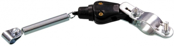

I mounted a spring pull switch on my brake pedal in tandem with the manual brake. The switch is off or on so just does what I program the controller to do instead of progressively increasing braking as I push the pedal more. However, the manual brake is on the same pedal and acts as a backup or if I need to stop faster than how I have the regen braking set. I almost never push hard enough to engage the manual brake. Here is the switch I used: https://www.amazon.com/gp/product/B0045LA6D6

EZ: not clear how that spring switch gets 1) attached to the brake pedal and 2) wired back to the brake connector on the speed controller. Any advice would be appreciated.

I rigged it up with some zip ties and a hose clamp on the same mount as the return spring. I'd weld a proper mount, but this has been working perfectly for over a year. The wires just connect to your brake signal line. There is no polarity; it is just a simple switch.

No problem. If the instructions aren't clear with the switch, the screws in the housing are the terminals where you attach your wires. You can see the wires in my picture if you look closely.

thanks again. God bless Amazon, the switch came in one day. Yes, totally unclear as to how to connect this thing. Thanks for the heads up on those terminal screws. Saved me a lot of head scratching.
