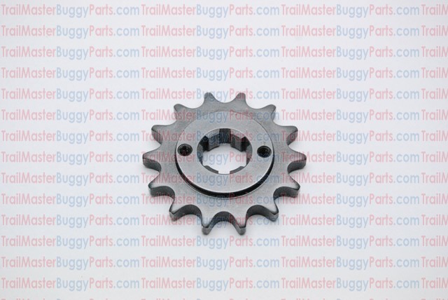

Thanks for the response. I reached out to the Hammerhead Performance website you referred to. Less than helpful. They appear to have a part which looks like it might work but they are refusing to provide me with measurements citing the trouble they get into if they are inaccurate. Here's the link for reference anyway:
I was hoping they would provide me diameter of the inner flange to see if it will marry up against my reverse gearbox.
