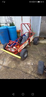

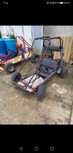

Picked up 2 more karts at a local sale... Because you can never have too many projects right 😅
The red one is pretty bad condition seized everything and no engine but the black one is basically ready to drive just needs a carb clean and brakes serviced
