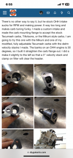

The Tecumseh has this terrible twisted intake manifold. I tried to port match and knock down edges in the casting. I don’t think fuel atomizes well in there so I just kept giving it more jet.IMG_4932.jpeg

The Tecumseh has this terrible twisted intake manifold. I tried to port match and knock down edges in the casting. I don’t think fuel atomizes well in there so I just kept giving it more jet.View attachment 144984
Good God Man!!! 🤢🤮🤢🤮🤢🤮
Basically the intake is too long and by switching the exhaust the intake pulse to carb time is tossed out if whack.
I can make way better (short or long) out of steel scrap!!!
Hell one of those 125 Honda dirtbike clone intakes would likely be better than that trash despite it would need cut and booted together to get the carb angle correct (unless you have the means to TIG sand cast aluminum)

You’ll need some type of angled manifold because these engines seem like they were built forgetting about the carb. Then they routed the carb manifold around the exhaust because they had no space.
(This might be on purpose to keep intake charge temps high so the fuel stays atomized.)
1,284
View attachment 144987View attachment 144988
What an idiotic sh!t design 😵
Would have made more sense to have had the studs positioned horizontally and done a set up a little more like a Briggs flathead which uses very close together ports.
No surprise Tecumseh went belly up making stupid designs like that.
I will say their 2cycle 196 is a brute that if given the standard procedural tuning and a few upgrades is a very scary engine

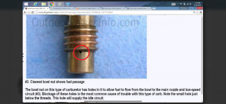

Main jet is the bowl drain bolt.
Pilot jet seems to be this one, that screws in horizontally.
I’m not sure if an adjustable jet will fit in your carb or not.
