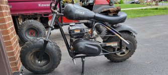

Got the Hemi valve cover patched up enough to stop leaking with some JBweld steel stick.
It really scoots right along without the governor and I haven't even pushed it hard enough to float the valves yet.
If I dropped the centrifugal (10t) and jackshaft (10:1 currently with a 50t on wheel) swapped a 212 crankshaft in for the 3/4" PTO (assuming the taper on the one I have will match up to the current flywheel)
What gains in top speed could I expect from 5:1 behind a 30series?

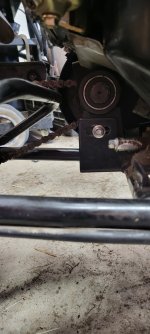

I got to looking at the jackshaft plate on it and compared it to my other 2 TC set ups... I think the CT200U-EX is larger than the 200U and other 200U-XX bikes. I think a TC might fit without a Riser or cutting the backplate.
I'd need to cut the packplate support tab off the frame but that's about it best I can tell.

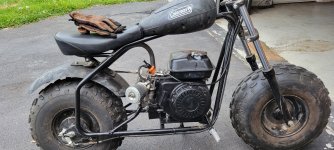

I did it...
I did that thing I probably shouldn't have done.
:smiley_omg:
It is Now a 212 Ducar Hemi Powered Coleman CT200U-EX that even at 5:1 has more than enough Get the F★ck lost to be be extremely dangerous. The front wheel has ZERO trouble reaching for the sky even at a 10 mph roll.
I haven't wound it all the way up to top end yet... but it hauls.
Needs a little bit of adjusting here and there but it proves the engine had no business on the build I plopped it on initially... I will be putting the 196 in its place.
1,296
Ducar 212 disguised as a Hisun 196 🤣
Its a fun little bike now... scary AF, but fun.
The answer to "Does a TC give better acceleration, or or a higher top speed" is: Both!
TC naturally accelerates better than a Hilliard, but whel you cut the final drive ratio in half by removing the jackshaft assembly (in this case 10:1 became 5:1) You automaticacally gain top speed potential.
