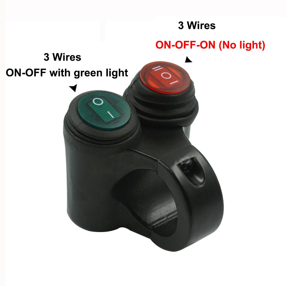

After some digging, I found the following as an option:
https://www.amazon.com/dp/B01ARJEHUW/ref=psdc_404724011_t3_B071HTWJ6K
Configuration would be:
red button = Kill Switch
Small toggle = headlight
Large winker = Fuel Pump (right on, left off) though I am unsure if this is momentary or not...
Drawback is I cannot find a Double Pole switch in any of these combined handle bar solutions. Winker switch FTW. I never realized switches could be so fun.

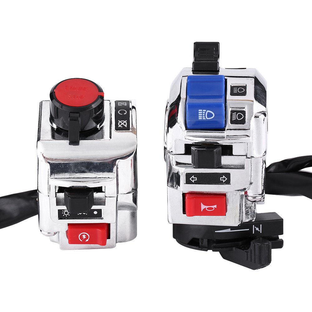

What switch is going to start the engine? perhaps this solution would be good:
https://www.amazon.com/Motorcycle-H...rd_wg=63KMX&psc=1&refRID=TC66FKZEV6EQ2G7S364T

Are you keeping the control key box shown in first post? To keep it simple, you can run constant + to the fuel pump and then use a simple toggle switch to send the neutral.
TT540
Newb
347
7
Huntsville, AL
By doing it this way, you can use a SPDT switch! The common middle post (#3) on the switch would go to Ground/Neutral/Chassis.
Post 1 goes to the Pump's negative (-) connection.
Post 5 goes to the kill switch yellow wire.
With this, you can now use the other more simple handle bar switch like this one:
https://www.amazon.com/Motorcycle-H...=1526566551&sr=8-15&keywords=handlebar+switch
Red switch up = fuel pump on
Red swtich middle = does nothing (starves the carb to dry)
Red switch down = kill coil.
Green switch up = headlight on
Green switch down = headlight off.
*this green switch can illuminate with the key-on position, head light on, or not at all.

So on the above switch, the third wire on the green light? Is that for the light inside the switch? If not needing a light, then I just use the two leads?
If wanting it to illuminate the switch when the headlight is on, then I just tap into the 12V headlight circuit to signal the light on the switch?
