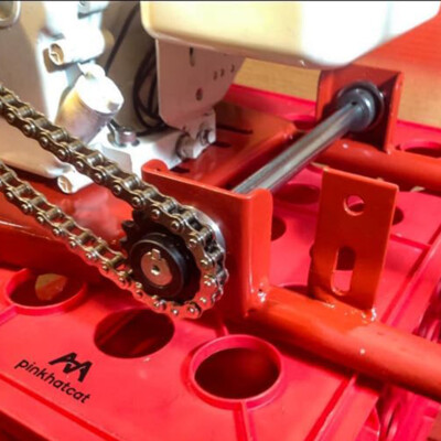

Is that a picture of one of your karts or his? I never saw any picture posted by him. Maybe he should just buy a driven with a 3/4" bore. Not popular, but they're available from some shops. Reading posts #33 where he ask if the washer should be rubber or metal, leads me to believe that he does not have a lot of mechanical experience. The bigger bore driver ( regardless of cost ) would probably be the easiest solution.
That’s a picture of my kart to show what type of jackshaft I think he might have.
Never seen a 3/4 driven and there is a lot of variables to look into before he can even install a 30 series.
If it’s some ”off-road 7hp gokart” as he stated I’m left to assume it’s a live axle with the sprocket hub welded to the live axle to match up to an outboard mounted clutch. OP should verify this with us before he even buys anything at all.
