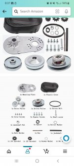

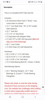

Now for your other little problem. I prefer spacers over the axle to keep everything centered. Are you sure all your sprockets and chain matches?
Thanks for the reply. My son will never be riding this without supervision. It will not be driven on anything other than pavement. Its very heavy and has a extremely low center of gravity and the width in nuts, roll over would be crazy to do. Anything is possible of course. And these are the items im using. All #35. 10T motor sproket and the bmi 2 piece # 35 axle sproketScreenshot_20221021-083715_Chrome.jpgScreenshot_20221021-083756_Amazon Shopping.jpg

Now for the original problem. Seems you have everything all matched up properly if it was my kart I would add a crossmember at the back of the frame to keep it rigid and then add spacer tubes to the axle to keep it all in place. Does not need to be heavy walled pipe. Just enough to be rigid. Even plastic pvc pipe will work in a pinch. Just make sure it is snug not tight to the axle.

Ntv03, it sounds like you know what you have there, but I just want to say that all of the CVT kits like that one that I've known about came with a 12-tooth #35 drive sprocket, and a 10-tooth #40 or #41 drive sprocket. If you're going to use a 10-tooth like you said, I hope you've made sure it's actually a #35 instead of the usual #40 or #41.
