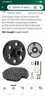

Where did you get the centrifugal clutch? How many teeth?

I will try first light. What about the clutch? CAn i add more washers or is that a bad idea? So to bug you on Saturday. And is there a simple way to fix the end of spring to frame to keep from moving with wobbly pedal? I was thinking a screw but that would look horrible and probably not last long. I did get seat done! Think it looks pretty good.

And a 60 tooth sprocket. It's much more narrow than the original 54 tooth sprocket. Old one has some worn teeth but if you think its usable I will and just get a new clutch and a #40 chain.

You can use the old wheel sprocket if you need to, I never throw anything away unless it's all used up.
Keep moving the clutch outward until it lines up with sprocket. But what if it doesn't? That's what kills me because not everything is a drop-in replacement. Most engines of this general size have mounting holes that line up with existing mounting holes on equipment, like a 6.5 HP Predator can go a garden tiller that had a 5 HP Briggs flathead because the mounting holes line up, but that does not mean the engine shaft will line up with the drive pulley, like on your go kart. :mad2:
