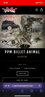

Oh no. I see 390 blocks for $70. Not sure if Japanese or Chinese.
I do love the look of those fancy welded blocks.
