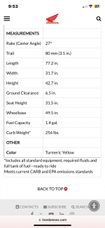

The curb weight of a Honda Trail 125 is 256 lbs with 1.4 gallons of gas… so we are less than that. I believe they get around 100 miles per tank… 70 miles per gallon ?
