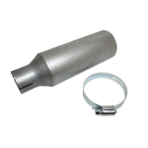

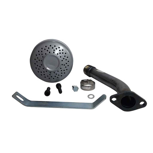

Something else, is there any kind of muffler that flows good and isn’t horrid loud? The straight pipe is deafening,lol. My neighbors are ok with my engine shenanigans, but I like to be somewhat decent on the racket.
A Muffler is like a Gun Suppressor! It's the Hot Gases hitting the Cold Atmosphere that makes the Sound. The Tuned Header is to make Power, the Muffler is designed to absorb some of the Heat and Slow Down the Hot Gases allowing them Time to Cool before exiting the Exhaust. Using to Restrictive a Muffler creates too much Back Pressure which Restricts hp made.
Download a Free Sound Meter App for your Smart Phone.
The direction you Point your Tuned Header makes a difference in what you Hear! There are probably 100's of different Mufflers out there you can use.
I suggest you Time yourself over a Distance like Stopped to 60ft, there are Free Apps for that also.
db at Idle.
db at Max rpm open Header.
db at Max rpm with Muffler #1
db at Max rpm with Muffler #2
db at Max rpm with Muffler #3
db at Max rpm with Muffler #4
If other People have the same Engine with a Muffler you can Record their db also.
The Bigger the Longer, the more Efficient it will be, but also Weigh more.
Muffler, Open Modified 1 5/16" $45.95​
Mud Boat Header & Muffler GX390 Predator 420 13-15HP Clone. $54.99​
Low Noise Super Silent Muffler Honda GX340 / GX390 Exhaust.​
Hmf performance**420 Rancher​
