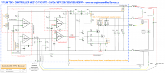

took it for a test drive and found a new problem...
it stutters when under load, and i think the reason is some other resistors are connected to the one i changed.
and when i change one the others might get offset too.
heres a schematic (i changed R31)
