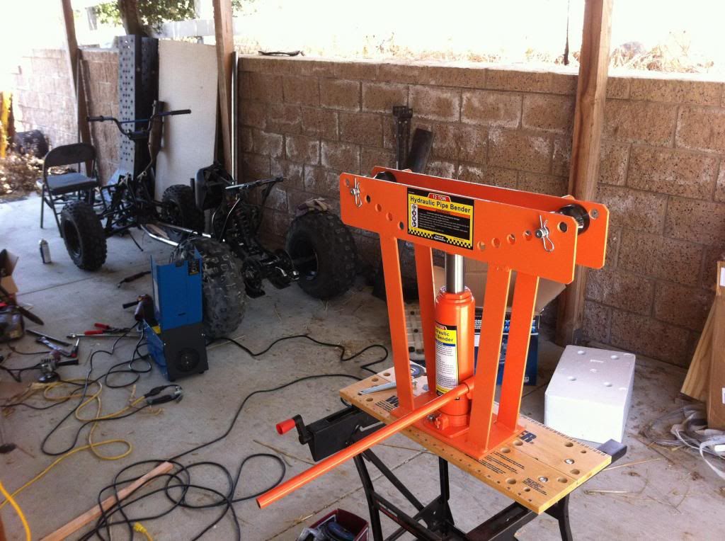

Anyone have experience of bending say 1-1/4 DOM in a HF pipe bender? aside from the die sizes, I see no reason why it shouldn't do the job (max 90 degree bends). Am I missing anything?

A pipe bender will just crush tube.
It's called a pipe bender for a reason, it's for bending pipe! If you want to bend tube you need a tube bender like this:

I saw this guy on you tube use a harbor freight pipe bender to bend tube. He just used a smaller die (eg 3/4" die on 1" tube)) the tube looked like it was not going to fit at all until it bent the sides first, then it slipped right in, then bent really nicely w/ no kinks. It looked really good after the bend was finished, even did a 90 deg bend with it no problem.
If i were going to bend tube, i would either:
1) pay someone else to do it
2) get a real tube bender
11-14 gauge would be my guess for wall thickness?

I've seen it too & other guys swear they can do it but, after trying it myself (1" tube with a 3/4" die, fill the tube with sand, you name it, I tried it) & having no success, I decided it's better to use a tube bender.
I wish I had bent my frame myself but, it was cheaper to have it made than to buy even a cheap tube bender

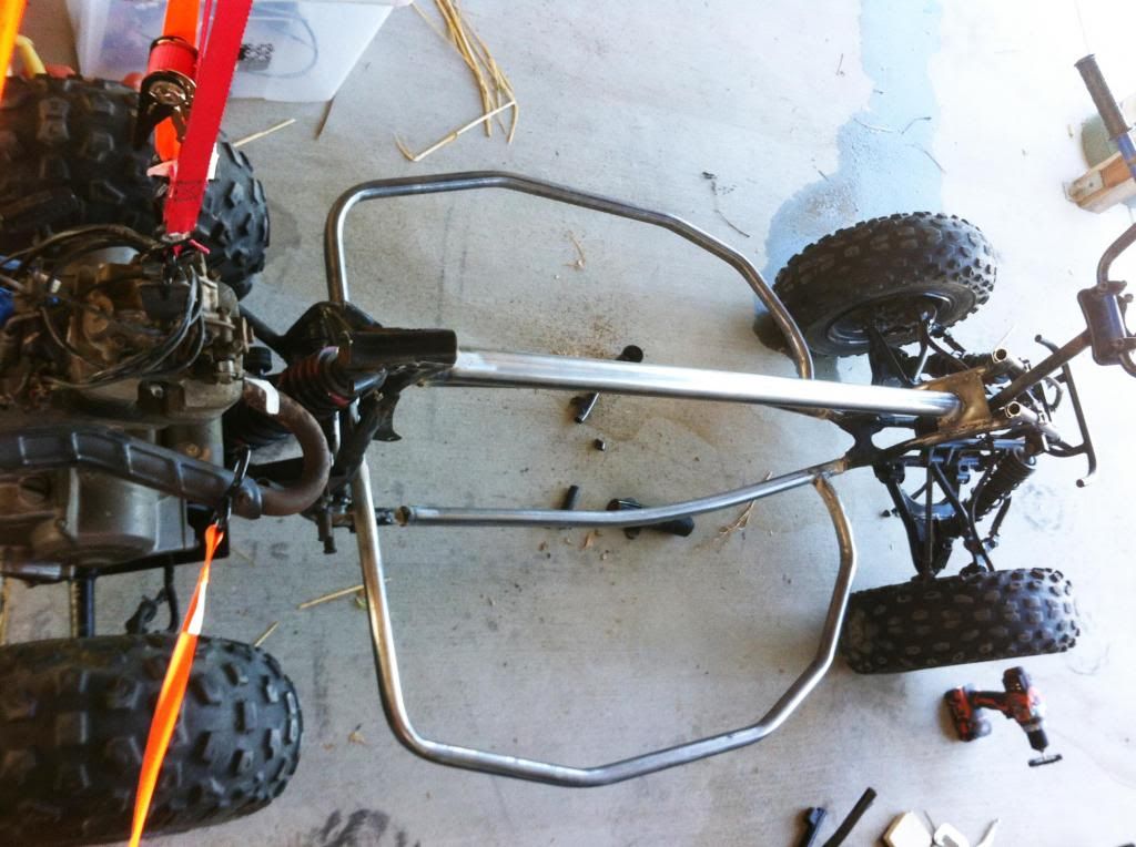

Thanks for the input guys. I went with mild steel in the end, agreed DOM is better, but overkill for this application.
I used 13g (0.095 wall) 1 1/4" tube which slid nicely over the old 1" tube where appropriate. Worked out well.
I did use the HF pipe bender, and while I couldn't quite get a full 90 degrees without it looking like it was about to kink, I got close, and I quite like how it came out. I just wish the fish mouthing had been as easy, I struggled getting the angles right.
[/URL]
[/URL]
[/URL]

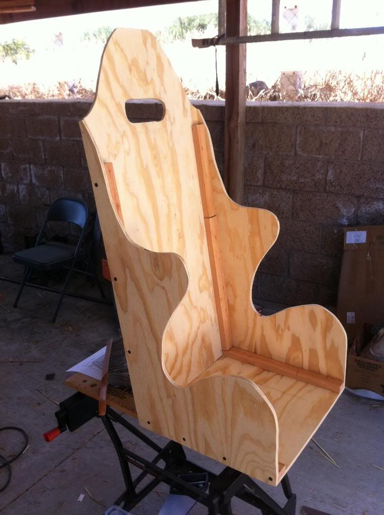

And I also made a mockup seat of the kirkey's I plan to buy so I can shape the rollbar correctly:
[/URL]
