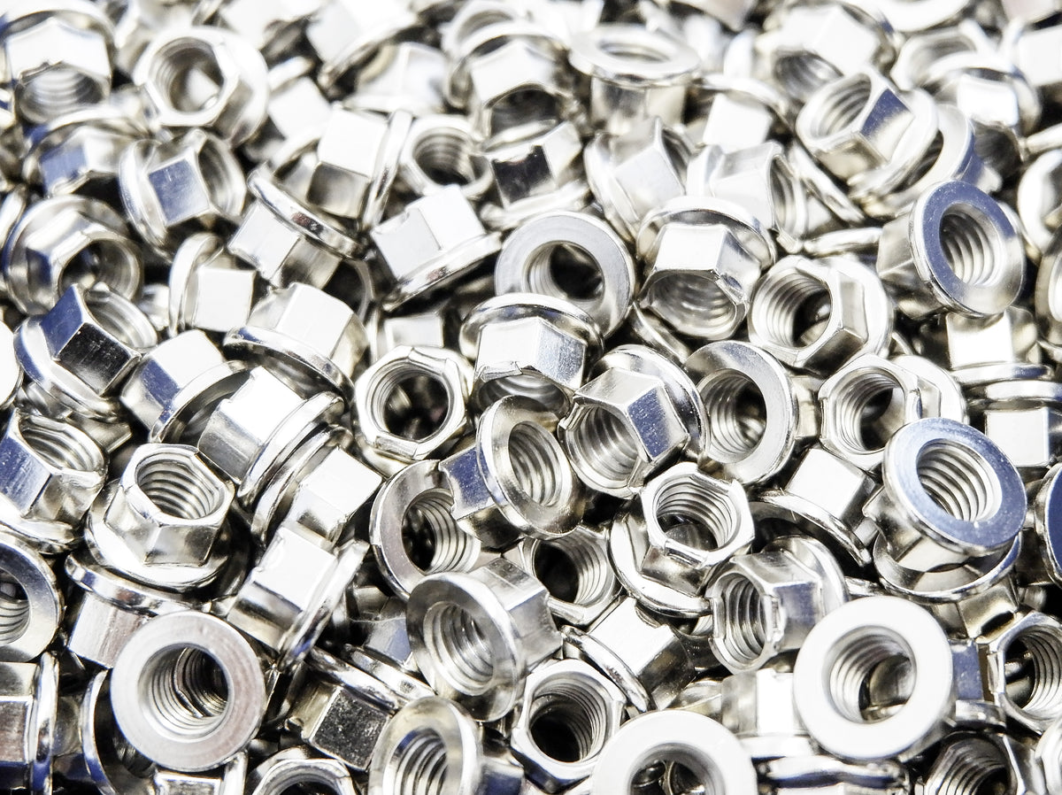

Sounds good Robert, the lug nuts you need will be the M8 size and look similar to these:

I constantly learn new stuff from this forum, the flanged nuts being used on a wheel is another new one on me. Shows my nearly complete ignorance of metric-focused equipment's mechanical aspects. Some facets are universal though, such as.................
The need to prevent loosening via vibration. I notice that none of those M8 flanged nuts are locking type flanged nuts, with serrations machined into the flanged faces. Are they intended to be used with separate lockwashers, or maybe locking star washers or similar?
Of course, my crazy OCD self would be using lockwashers under them followed by another nut, double-nutting them so I could completely put them out of my mind insofar as worrying about them ever coming loose is concerned.
Of course, my crazy OCD self would be using lockwashers under them followed by another nut, double-nutting them so I could completely put them out of my mind insofar as worrying about them coming loose is concerned.
Nope no extra hardware is needed, I raced karts on tracks for quite awhile and never had a lug loosen. The center bore of these hub centric rims fit over the hubs so tightly, I always had to knock the wheel off the hub with a rubber mallet after removing the lugs. That tight fitting hub connection is actually carrying the weight and centering the rim instead of just relying on the taper of the lug nuts, this reduces the possibility of the lugs loosening. Those flange nuts also have a much larger contact patch than conventional bevel faced lug nuts, which probably helps to (y)
