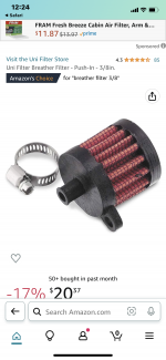

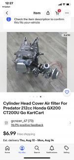

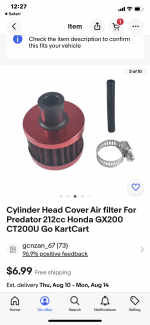

I usually find some kind of breather filter and modify the stock hose if needed. I don’t remember the hose size or size of filter that works best.
