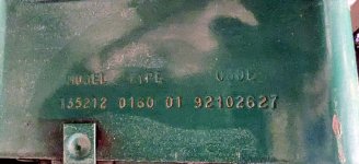

Here are the shroud stamps from each of the green machines:
Last year's find is date coded "900127",
while the newer one is stamped "921026". So, both of these lil' zappers came from assembly plant #27 just about 2 years and 10 months apart. Might even have been built by the same employees.

Those simple old Coleman generators are great for job sites and remote locations. The small tank only runs about 2 hours, but for power tools they are great. I would check the output and keep the generator that works better; use the other engine for a kart or bike.
Those numbers are date codes. the 13xxx is the engine type.
