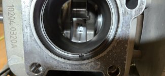

@Hellion mentions it all the time, as do other members BUT make sure you research and find a sufficient filter for the environment you drive in. Those "stage 1" filters are literally useless.
Here's the filter that comes with the "stage 1" kit from Gopowersports. It's maybe 10 hours in a pretty dusty environment.
-and then here's my "upgrade"
also spenny WHAT CAM DO YOU GOT i know mines bad but gawd dammm
or was that your picture?

I don't know how long you've been running it like that with the cone filter but if it's, say, several weeks or a month of good usage, you might want to check your ring gaps. The factory air box is tops IMO. Edwin's thread keeps paying dividends. ✅
