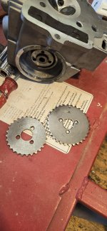

I recently traded for a trailmaster 200xrx (bad trade on my part but it helped a kid out). It was blowing smoke like a chimney so I tried to replace the top end but while doing that I snapped the timing chain. I need help finding a replacement motor for it that isn't 1100 dollars. The way I see it I could just buy a new one for that cost. I am decently good with tools but I can't find a full rebuild kit for the motor if that is a possibility I might do that instead. The motor says Engine ID: 161 QMK / 161QMK

I think I've found a timing chain but to put it back on I'm pretty sure I'll have to split the case and completely rebuilt the motor and I haven't found anything besides the top end for sale online

There is a lot of different gy6 motors my concern is if I don't get this exact model then other ones won't fit and it would be plug and play
Show us which one you got! We likes photos. Just upload them directly to the site. 📷
