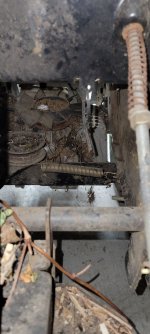

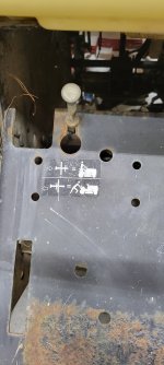

those transaxles are pretty good, did a mower a while back with one of those in it. swapped it out for a 5 speed though.
1,296
do you have a picture of it? sounds interesting... how much would you want for it?
Nah, I can get you some. I'll message you so not to muddy up the thread with it
