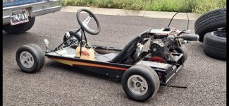

An info dump on the well-known go kart frame and/or kit sold by Azusa. The basic frame is just $375.00 at this time.
The main controversy or strangeness of it all is that the frame is so short [48"] in length and coming from the long history of Azusa and adult karting and mini biking, that is a bit odd. Go karts are cramped and small by nature but the Azusa seems really small, but I admit I have never seen an adult or someone of large stature on one of these frames as they are supplied from the factory.

Its a cool little kart, and have also heard that everyone lengthens them in the end as they are super short
The real game changer, the eureka moment I think for me is seeing the heavily modified one with two engines. The lengthening was accomplished at the front with an extended “front porch” I think they call it.
Seems way way more practical to do it that way and then you have a proper front “bumper” too as many karts do. Azusa should sell a front porch kit as an option. I wonder if their kart frame is short for reasons to do with shipping. Back in the old days there was no such thing as free shipping and more and more weight was prohibitive.
