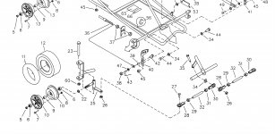

Here’s an illustration of a Manco 297 front-end. Parts 26 and 27 are Nut, 3/8-16 Toplock and Bolt, 3/8-16 x 1.50” respectively. Just throwing the hardware sizes out there because your existing tie-rod end may have a 3/8” bore as well.
[ Click to embiggen ]
