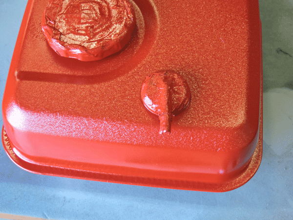

Well, that's not exactly true. Many times these modern formulated paints have critical recoat times....and usually, you can recoat in under an hour, however, miss that window, and some require as much as 10 days wait.
But, why are we even talking about this????? Already pretty much covered earlier in this thread.

I had this same issue a while back...
I'm fairly certain the issue is that Rustoleum takes longer to fully cure than what the instructions on the can recommended. I waited well past the time frame and still had the cracking when I applied the clear coat...
On re-coats of paint, there is a certain amount of flash time, which depends on the type of reducer in the paint and the temperature in the room, that you have to wait between coats to allow the solvent in the paint to evaporate. Too soon, and the solvent can react to the second coat ruining the first. Too late, and you need to lightly scuff the paint for the second coat to properly adhere to the first coat. I was told to always let the first coat flash a little longer than the directions (lightly tacky), then flash the other coats as recommended. This is because the first coat is what is adhering to the surface.
With spraying clear coating, you want it fully cured. Usually you want to wet sand and buff out any imperfections in the paint before clear coating. I didn't because it was just a gas tank. It was fully dried to touch so I assumed it was cured. My friends who are painters told me if I had tried to wet sand first I would most likely notice it getting tacky or gumming up my sand paper, thus not fully cured. They recommend always to at least find a hidden spot that won't be noticeable and wet sand it first to test before clearing. If you can lightly sand it past top coat without surface changing textures, it's fully cured.
Whether you have to wait 24 hours or a week for it to fully cure depends on a lot of factors...humidity, temp, reducer, paint product, etc.
Just what I've been taught, hope any of that helps...

Ok....Have I ignored the recoat times and I gotten away with it???? Yes. Have I waited very close to the prescribed week and had problems? Yes. With not only the same brand, but the base coat, not clearing over, but just applying another coat.
Now, being an ex-professional spray painter, I can appreciate the control afforded by mixing your own paint / thinner combination. However, not everyone has that luxury and without any specific information, it's basically chest thumping drivel that has nothing to do with this thread, which was about a rattle can problem.
BTW: The paticular paint I had a problem with was Dupli-Color engine enamel.....Can't find that in a can, and polyurethane isn't really formulated for high temperatures is it?
So, while some of what you have posted is useful information, some is not....bottom line....read the can...follow the directions....they are there for a reason.

AS a auto body repair guy, for 20+ years,,,, what I see,, is called "Lifting" If you put a lacquer based paint on an enamel primer,,,, this is the reaction you get.
The Lacquer is WAY stronger of a solvent, then the enamel reducers.
EVERY coat you put on weather primer, paint, or clear coats The solvents actually go from the sprayed coat, all the way to the metal,, and then back out the layers,, and evaporates as it dry's. While painting a car in a booth,,, you have the opportunity to have not only the air flow,,, but a bake cycle, that speeds along the solvent evaporation process. after a good 30 mins or so,,, you can then go in and apply more color coats,, or the clear coat. But all of the primers,paints, Clears,, have the same base solvents, and are the same brands.
Thus mixing brands of base, color clear, is asking for troubles.
IMO the sand blasting, then powder coating would be the better way to go.

That's only what you think you see...these modern day enamels are formulated to act more like lacquers nowadays than the oil based enamels of old....
Trust me...it's because of the critical recoat times some of these paints have that caused the problem....been there, done that....The results indeed mirror aplying lacquer over enamel ....but as I stated earlier, I've had this happen with literally the same rattle can of paint....and if you read the thread, the OP used compatible products and simply applied in that forbidden window.
