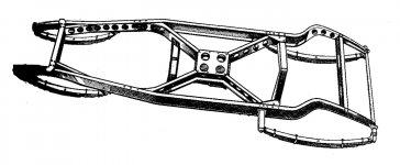

Thank you for the enlightment! Great source of information and nice to get some technical terms of what the types of frames actually is called.. I was actually thinking of a ladder frame, as due to simplicity. It says it's not strong enough and therefore they upgraded to tubular frame, BUT I think for this purpose it will decrease the complexity and maybe even make it possible to go offroad
The attached photo is pretty close to what i had in mind. I have access to a CNC punching machine and the CNC press brakes aswell so it would very easy to replicate and even better to produce - so I can go race in the woods with a couple of these bad boys ;)

Your welcome :thumbsup:
It looks like you have lots of research & design ahead of you, before you "brake" or "press" anything ;)
Your pic is what's labeled on the pic as a ladder frame, but that's not what I've ever called a ladder. In my vernacular, a ladder frame is a matching pair of long lateral rails positioned above/below each other with perpendicular (90-degree) little braces vertically placed between them, and I would never build one that way. A truss frame has the same lateral rails, but the braces are attached between them at a 45-degree angle in opposing pairs, point-to-point. It has a great deal more resistance to racking movement, and unlike a (90-degree bracing) ladder frame it can be built with much lighter materials than a straight beam construction frame like in your picture. Less weight, stronger frame.
