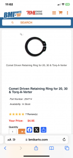

I haven’t run into a clip like that before. Looks frustrating. When you do get it off can it be replaced by one like this?

It was mangled after taking it off. I'm an *** bc I knew I should have been using clamps to take the pressure of the spring off and waited until it was too late. I bought one from I believe comet kart along with garter springs (maybe a mistake at 3600rpm) new green spring, buttons (IMPOSSIBLE TO INSTALL). It's not back together yet b/c I keep saying I already went this far, may as well upgrade more! New carb, intake, Header, Wheel bearings, Brakes, and rear tires. Now I can't get her to run right. Anything less then full choke it stalls out. You got the Channel lock pliers didn't you? Lol. I've become a frequent visitor of Harbor Freight the last month. I've got more tools then an apprentice in every trade. lol
