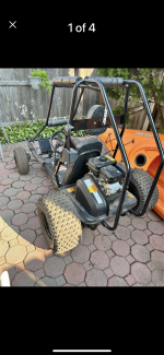

Hello,
I picked up a beautiful dingo with a 5 hp Subaru and I’m looking to get this kart up and running. I’ve had it for a week and I’m realizing I need to clean this carburetor. Is there any information on how to do this for Subaru e13 engines? I’ve looked online and I guess these engines aren’t very popular. I’m thinking about taking it to the local mower guy because I don’t have any experience. For the same cost I could probably install a predator but I’d hate to do that.F6BB4764-E643-4726-9DAD-B432BE1948FB.png If anyone could help me out I’d really appreciate it.
Thanks,
RG

Hello and welcome! The reason the Subaru engines aren’t popular is the astronomical parts prices. Cleaning carbs isn’t that hard, look up a YouTube video of any generic lawnmower.

I can’t believe it but I cleaned that carb and it’s running. I want to thank everyone for the motivation need to order helmets so we can get riding videos to follow. It was surprisingly easy. I took it all apart, poked it all out with tiny brushes and it started after 3 pulls. I don’t know what to say. Videos to follow!!! Yeah Subaru E17.

To ensure a thorough cleaning I soak the carb in Chem-Dip for 24hrs, poke all holes with a guitar string ( stiff enough but flexible ) and use compress air to blow them out. Do not soak the diaphragms, O rings, gaskets or plastic parts.
