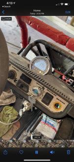

Here's the new speed sensor installed, does that look like enough clearance or does it need to be further away? The bracket worked pretty good, though I slightly undermeasured the length of the arm extending towards the rotor, so I had to bend it out slightly. It registers on the speedometer now though, I originally had it bent too close and the magnet took a bit of the shiny plastic off the edge of the sensor.
The last picture is the wiring setup for the speed sensor for how it connects to the front harness so I or somebody else can referense it later if need be.
