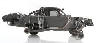

I’m confused… if the hinge point of the swing arm is in front of the seats… why not just keep moving it forward until the hinge point of swing arm is the front axle?
What I’m getting at… is there a point where the hinge is so far forward that the swing arm no longer does what a swing arm should do.
If the seat is on the back part, it no longer separates the rider from the swing arm. Why even have it?
Am I not understanding the idea of suspension correctly?
It would be like putting the seat on the swing arm of a motorcycle??? Why???
Somebody please correct me if wrong, but it makes no sense to put the pivot in front of the seats.

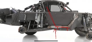

I drew this picture to play Devils Advocate with myself. I guess the pivot point can be in front of the seat if the seat attaches in front of the pivot point.
