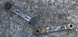

I really hope this site on the backend is refreshing itself and the admin/mod isn’t babysitting it having to refresh it 20+ times a day. IMG_9212.jpeg
